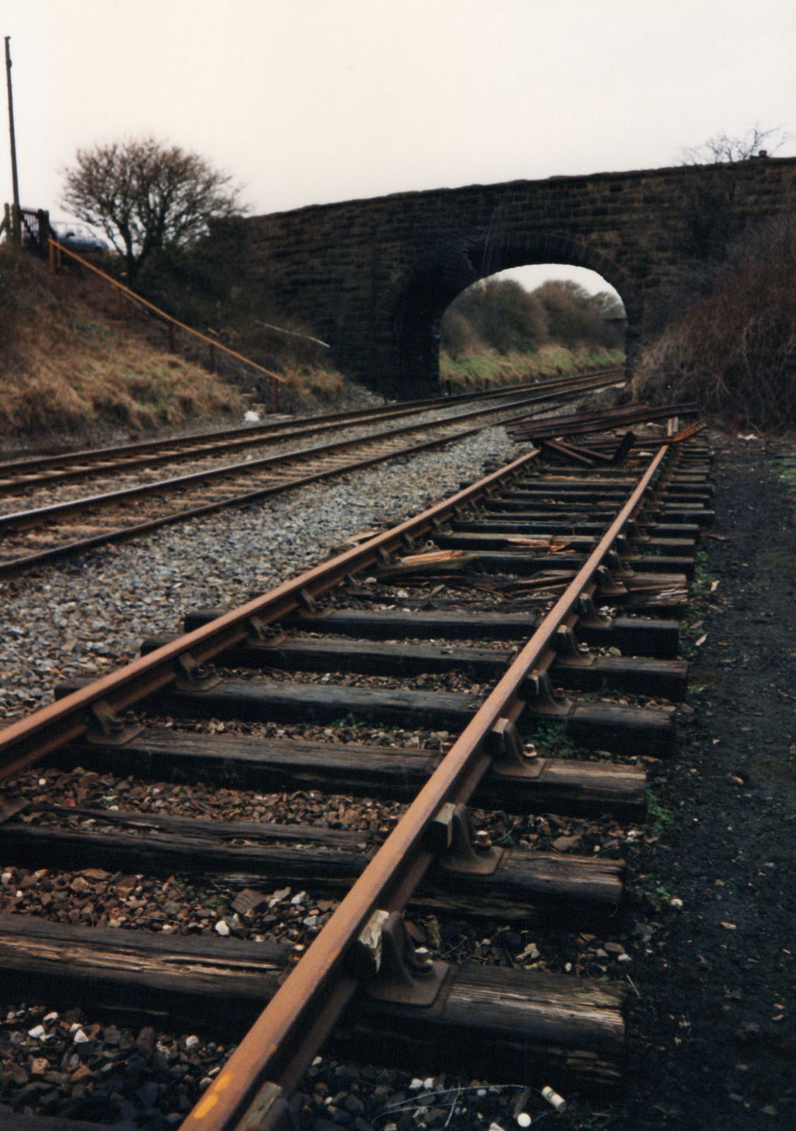

On the evening (about 19:00 to 20:00) of Friday 5th February 1988 two-car Carlisle Kingmoor Class 108 set 54250 (leading) + 53967 on a service from Barrow-in-Furness emerged from under the road bridge at Warton beside Midland Bottom End Yard at Carnforth and struck an engineer's wagon. The leading bogie of the DMU became detached and the body rode over the wagon. There were minor injuries to passengers (the DTC contained just six passengers), with one lady requiring Hospital treatment.

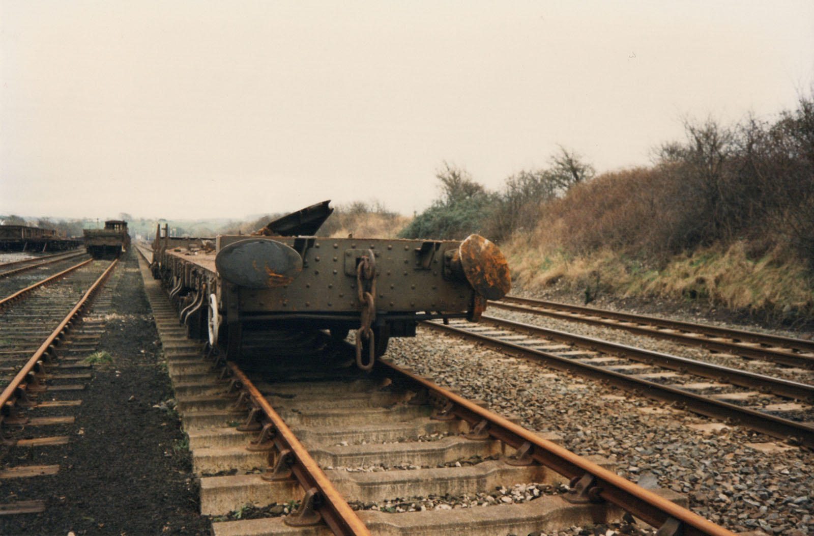

The long welded rail train for the forthcoming weekends work was being reversed into No.1 sidings in the dark. Moving at slow speed, the shunting crew were unaware that they had stuck wagons already in the siding, propelling one through the buffers, derailing it to foul the Up Furness line.

Damaged track Damaged wagon DMU cab seen between other vehicles in yard Bogie with DMU behind Buckled bogie under DMU Rear end of grounded DMU body Damaged components under DMU power car Dislodged battery box and buckled bogie
